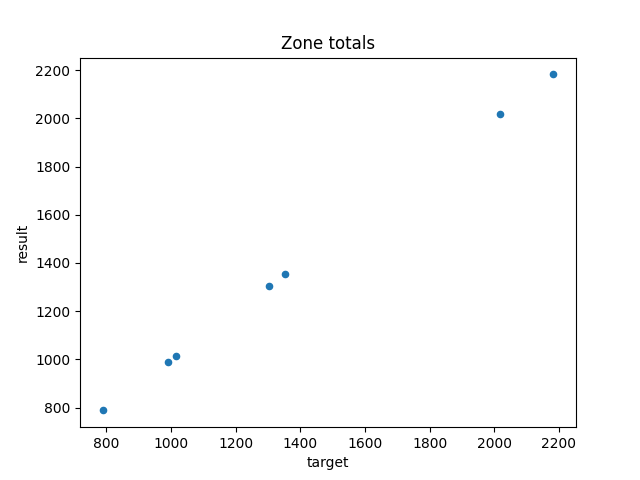

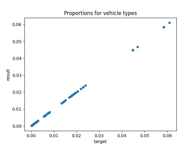

# Two convergence scatter plots are also saved with the outputs for a quick sanity check
rv.save_results(join(gettempdir(), "veh_distr.csv"))
  • Proportions for vehicle types
  • Zone totals
