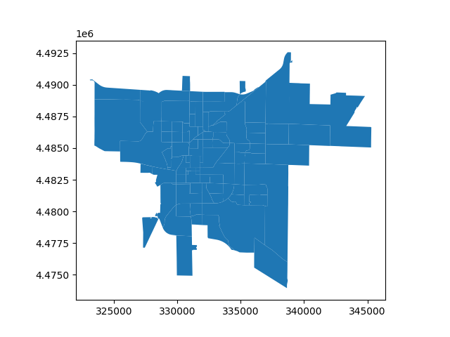

new_net = Network.from_file(target / from_net.path_to_file.name)
new_net.data_tables.get_geo_layer("zone").plot()
# It is HIGHLY advisable to inspect the result of this procedure, as
# undesirable artifacts from the spatial operations may have been introduced
plot change zoning system
<Axes: >
