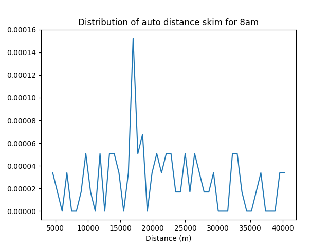

We can also plot a histogram (Distance frequency distribution)
import matplotlib.pyplot as plt
c, x = np.histogram(np.ravel(dist_skim), bins=50, density=True)
plt.plot(x[:-1], c)
plt.title("Distribution of auto distance skim for 8am")
plt.xlabel("Distance (m)")
Text(0.5, 23.52222222222222, 'Distance (m)')
