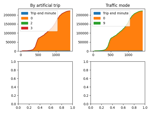

Plotting aggregate results#
def chart_metric(df, metric: str, axis=None):
    df.plot.area(ax=axis)
    axis.set(title=metric)
df = kpis.m_etric_traffic_cumulative_gap()
fig, axis = plt.subplots(2, 2)
all_axis = [axis[0, 0], axis[0, 1], axis[1, 0], axis[1, 1]]
for metric, ax in zip(df.metric.unique(), all_axis):
    df_ = df[df.metric == metric]
    df_ = df_.dropna(axis=1, how="any").sort_values(by="Trip end minute")
    chart_metric(df_, metric, ax)
# Combine all the operations and display
plt.tight_layout()
plt.show()
By artificial trip, Traffic mode

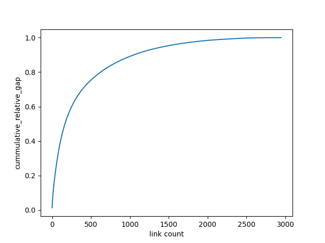

Cummulative charts#
import seaborn as sns
import matplotlib.pyplot as plt
cumm_links = gap_per_link.sort_values(by=["absolute_gap"], ascending=False).reset_index(drop=True)
cumm_links = cumm_links.assign(cummulative_relative_gap=cumm_links.absolute_gap.cumsum())
cumm_links.cummulative_relative_gap /= cumm_links.cummulative_relative_gap.max()
sns.lineplot(data=cumm_links["cummulative_relative_gap"])
plt.xlabel("link count")
plot convergence analysis
Text(0.5, 23.52222222222222, 'link count')
